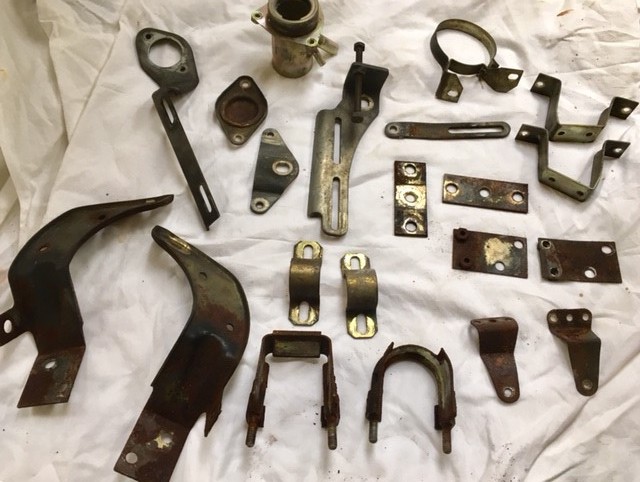

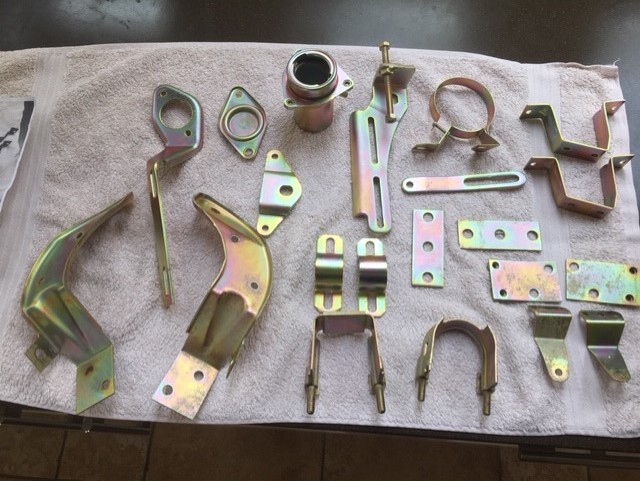

[attachment=573][attachment=574]
Got a bit of re-plating done, Zinc and yellow.....rough cost at most platers would be about £40-50, but doesn't it make a difference!

Certainly surprisingly cheaper than the equivalent cost for powder-coating which is my recent experience.
23 Jun 2019, 07:55
But more importantly Richard.....its as the factory did it!
Not I slavishly want everything to look 'Factory'....but as you say, if it doesn't cost shedloads of money and it looks good why not?
I regularly fit self-bleeders, better exhaust systems, better otterstat pipes, battery isolating switches, upgraded springs, better electrical relays and LED bulbs etc. These make the car more useable, but most of them 'Joe public' wouldn't spot.
24 Jun 2019, 13:11
(23 Jun 2019, 07:55)Chris P Wrote: [ -> ]But more importantly Richard.....its as the factory did it!
Indeed, if one is doing them anyway, then they might as well be 'right'.

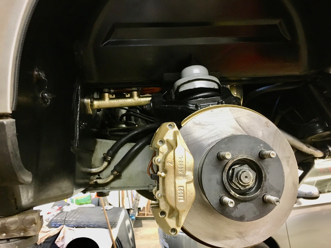

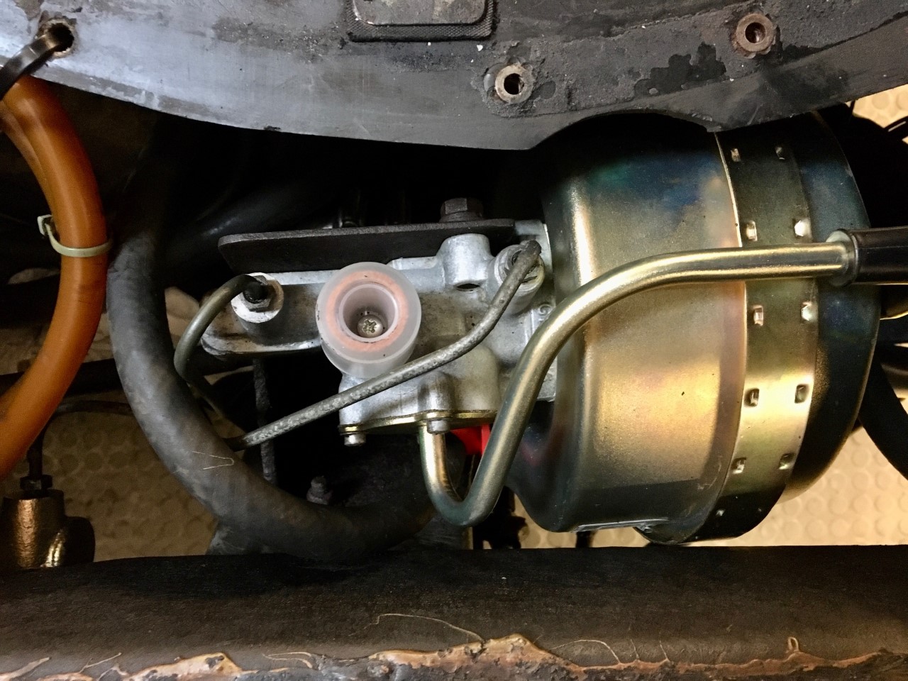

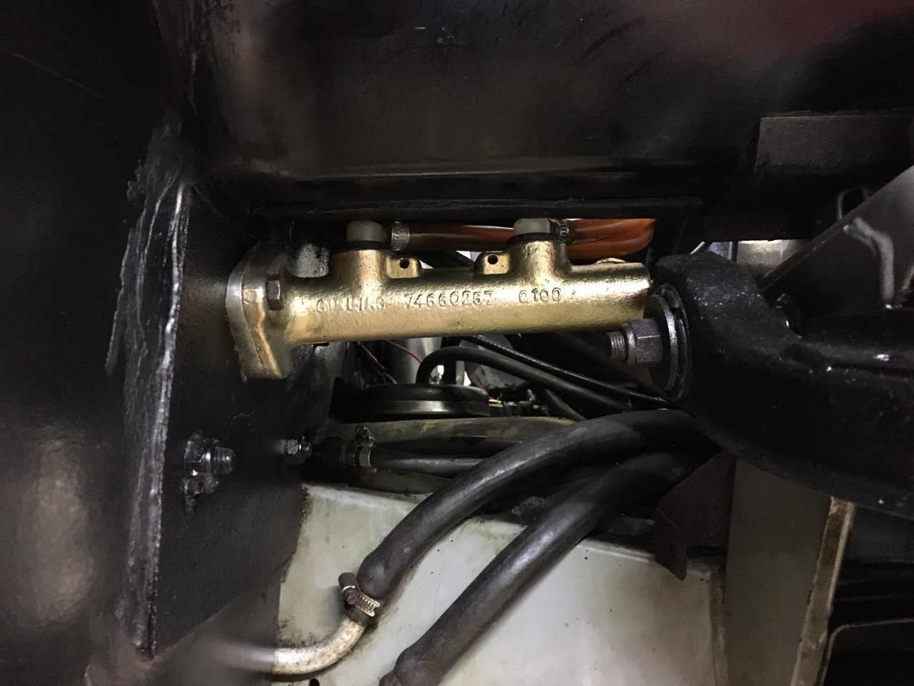

[attachment=681][attachment=680][attachment=679]A little update folks.....two steps forward, one step back!
I was a little careless yesterday. Now I've finally bolted on the refurbished Master cylinder, and last servo, all that was needed was to bleed the brakes! .....easy..?
I usually use one of those device's that pressurise the brake fluid with air from your spare wheel. Not normally a problem......except when you forget that it was pumped to to 50 psi , so I could push the car easily around my garage! Result? It blew of the plastic fitting off the top of the master cylinder and sprayed brake fluid all over the place....incuding my recently scrubbed garage floor!
I'll have another go tomorrow!
