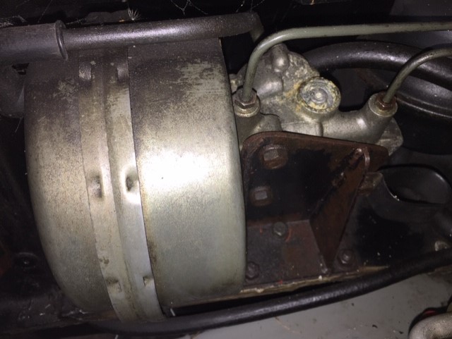

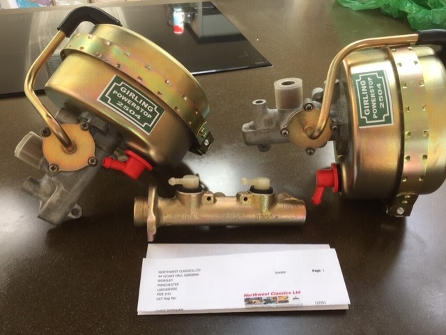

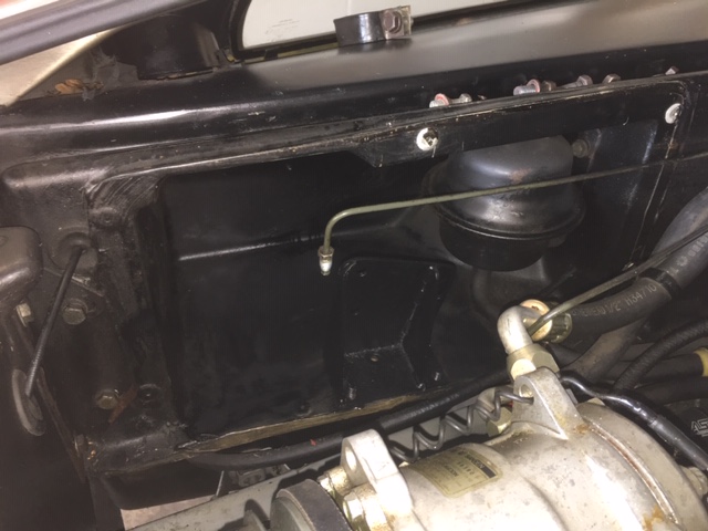

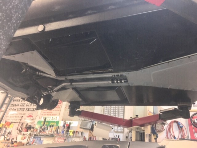

A little update...still working on the brakes, my refurbished Brake servo's and master cylinder arrived yesterday , made a start fitting them, but packing for my holidays is more urgent!  Wink

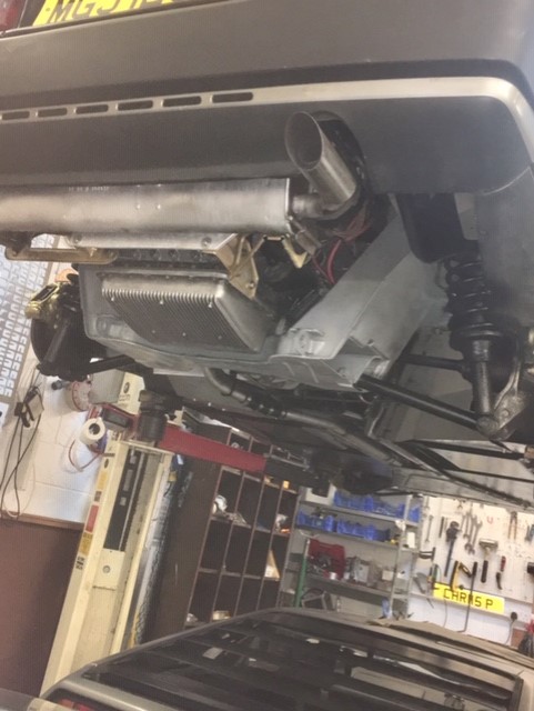

The brakes have probably been the biggest challenge. "living the outdoor life" as Matt puts it has taken its toll. I've had to replace or restore every single part of the braking system. Still not quite finished, due to holidays intervening, but nearly so.
Getting stuff 'to bits' was the biggest challenge ...you don't just pop a spanner on it and off you go!! Oh no, every single nut bolt and washer was sized up solid. A lengthy and tedious series of.... WD40.... Heat gun....hammers and spanners, etc. has eventually won through. But I wouldn't have liked to tackle the job without a lift......and lots of spare time. One hasty action and you end up with something 'snapped off'. Angry   That hasn't happened, i've been careful, if long-winded. You have to be a bit like a Doctor..... "First do no harm".
Everything that needed to come to bits, has been, and put back together with oil or copper grease etc. Rolleyes
If only the Waxoyl that was used on the top of the engine (30 years ago) had been sprayed underneath the car....this job would have been done months ago. Still...on the final lap now.  More later. Smile

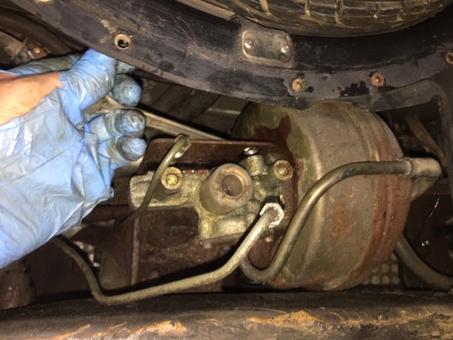

            A little update folks.....two steps forward, one step back!
I was a little careless yesterday. Now I've finally bolted on the refurbished Master cylinder, and last servo, all that was needed was to bleed the brakes! .....easy..?
  I usually use one of those device's that pressurise the brake fluid with air from your spare wheel.  Not normally a problem......except when you forget that it was pumped to to 50 psi , so I could push the car easily around my garage!  Result?  It blew of the plastic fitting off the top of the master cylinder and sprayed brake fluid all over the place....incuding my recently scrubbed garage floor! Blush
I'll have another go tomorrow!
