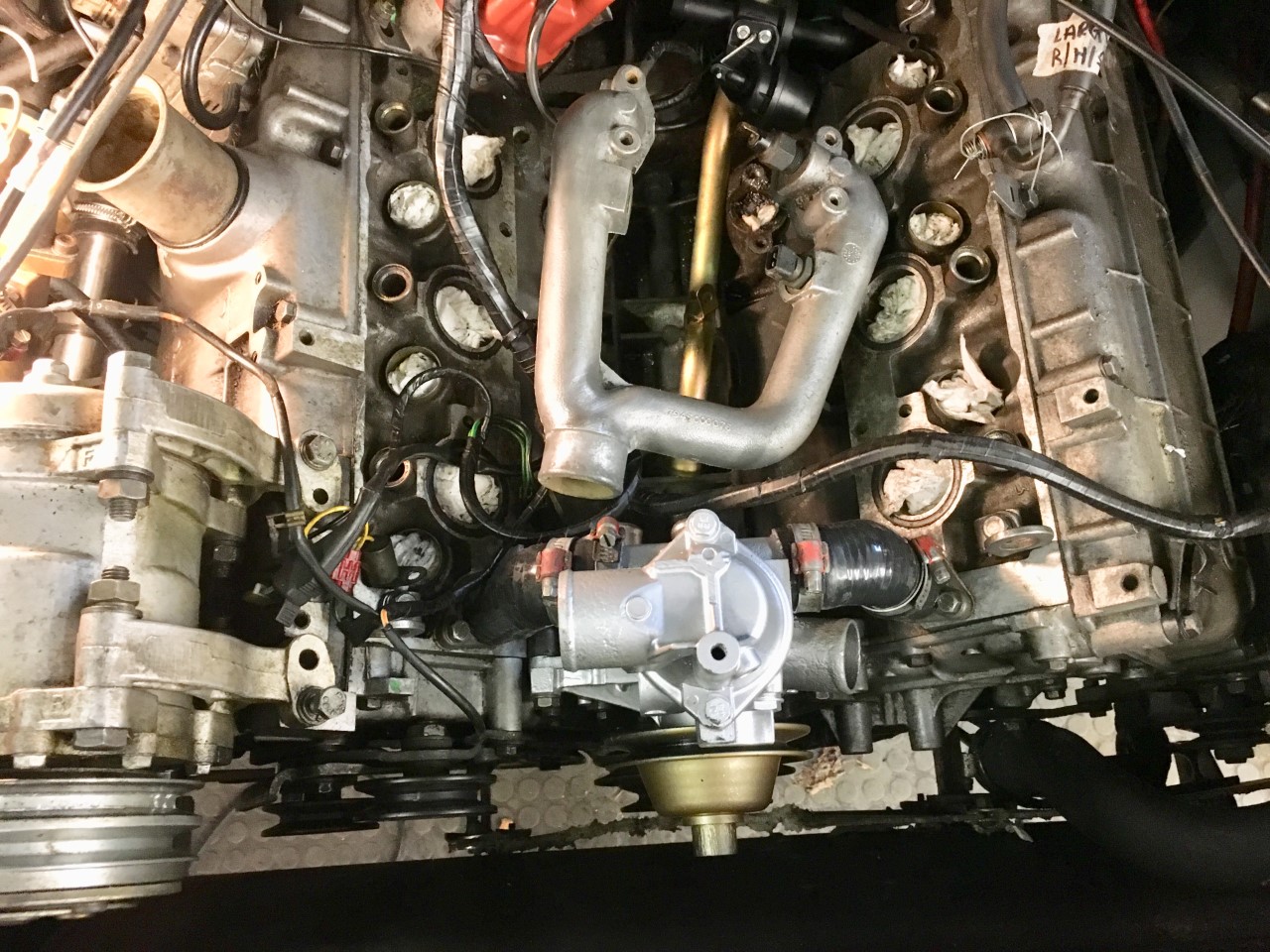

Water pump going back on today, after Dave H had it restored. New bearings fitted in the idler pulleys, (one was sized up, the other not much better)' The lower mounting bracket/adjuster, was badly bent as some heavy-handed mechanic had tightened up the long tensioning bolt too much. I replaced it for one I had in stock.
 Lots of other stuff to do before I finally put the inlet manifold back. including fitting the new lower water pipe and vacuum heater valve, spark plugs.....(all from D-Go)  etc etc etc.  Rolleyes

[attachment=463] My work in the 'Valley" is now complete. New plugs and  leads, new o rings, lower water pipe, hoses, clips gaskets etc etc.
It now starts on the button , and the horrible noise generated by the idler bearings and water pump has now gone. I've changed the engine oil and the oil filter twice. New drive belts and the water is circulating around the system properly and the fans kick in and out.
Next job is to flush out the cooling system again and put the antifreeze in...when I'm sure there are no leaks.
 Cant do that until I can get it back on its wheels and I can't do that until I finish the extensive work on the brakes, which may  take a good few weeks yet....... But its getting there!  Smile

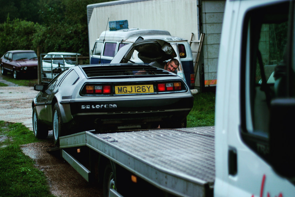

As I prepare for another days work on the car (the joy of being retired) and have reviewed this thread, I realise I've failed to give my good chum and family friend Andrew Westerman, much credit!
My apologies Andrew.
Not only did Andrew hire a transporter and drive down to 'Battle" and back, to load and collect MGJ with Matt, and then safely delivered it into my garage, but he has helped and advised me on numerous occasions over the last few months, as I've been working on it and trying to get it going.
..It only seems 10 mins since, I took him for his first a ride in a DeLorean as a teenager,....now years later,  he has bought and sold and more importantly, imported and re-commissioned more cars than anyone else I know!

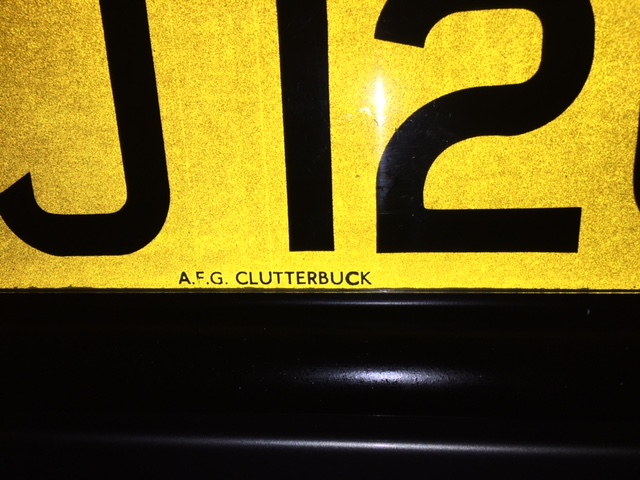

Im guessing something like "VTB 1588" or "V..5883" from what the very faint writing says.
Maybe a number based on when it was being converted to rhd?
