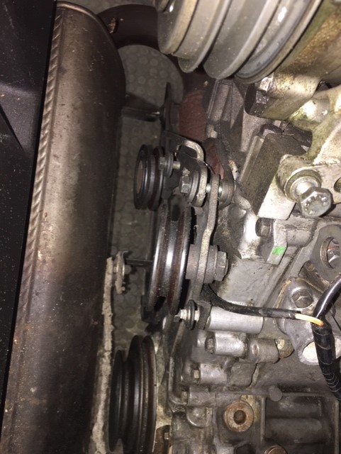

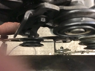

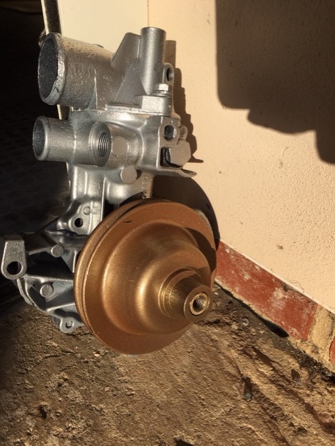

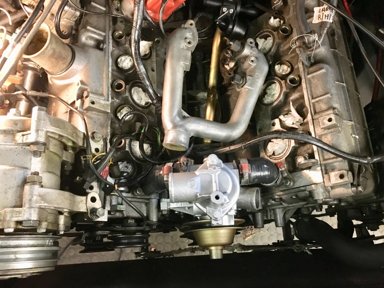

Water pump going back on today, after Dave H had it restored. New bearings fitted in the idler pulleys, (one was sized up, the other not much better)' The lower mounting bracket/adjuster, was badly bent as some heavy-handed mechanic had tightened up the long tensioning bolt too much. I replaced it for one I had in stock.
 Lots of other stuff to do before I finally put the inlet manifold back. including fitting the new lower water pipe and vacuum heater valve, spark plugs.....(all from D-Go)  etc etc etc.  Rolleyes

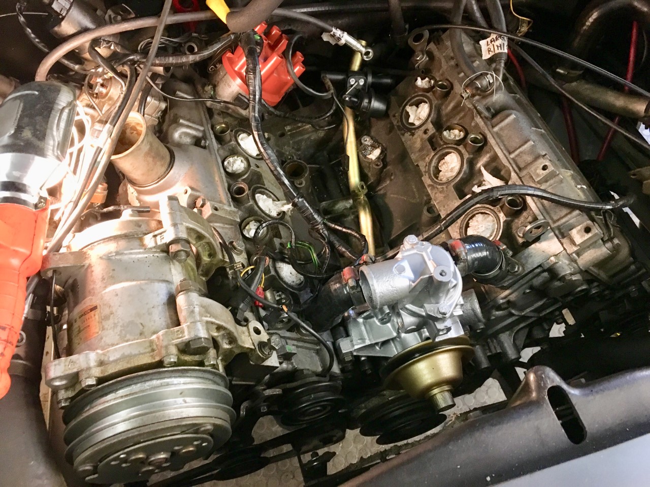

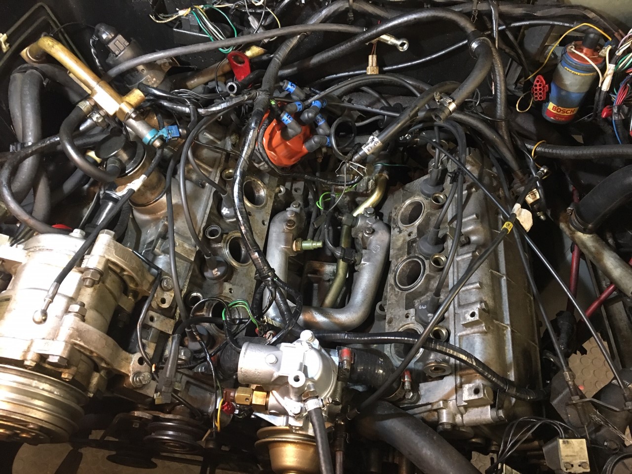

     My work in the 'Valley" is now complete. New plugs and  leads, new o rings, lower water pipe, hoses, clips gaskets etc etc.
It now starts on the button , and the horrible noise generated by the idler bearings and water pump has now gone. I've changed the engine oil and the oil filter twice. New drive belts and the water is circulating around the system properly and the fans kick in and out.
Next job is to flush out the cooling system again and put the antifreeze in...when I'm sure there are no leaks.
 Cant do that until I can get it back on its wheels and I can't do that until I finish the extensive work on the brakes, which may  take a good few weeks yet....... But its getting there!  Smile

The self burper /bleeder was partially installed...in that had a through-nipple had been fitted to the top of thermostat housing, and a short bit of pipe fitted. I replaced this to our normal tee piece in front of the header tank and a pipe around to that.  It only took  a few mins to bleed the air out and am I very relived that it now keeps nice and cool.
The radio working is a bonus, obviously the damp had not done too much damage.  It doesn't seem to be charging properly, so I will have to investigate that.
Matt, the green had done its job.....it was Waxoyl that was spayed all over the engine when it was laid up. Obviously, when later exposed to the light and weather outside...it had turned into some sort of mould...but it had partially protected stuff.
